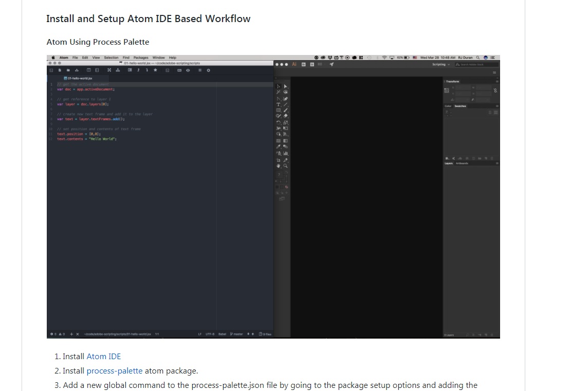

Я следовала вот этому tutorial - rjduran/adobe-scripting
но похоже что там код для Mac
  1. Install Atom IDE
  2. Install process-palette atom package.
  3. Add a new global command to the process-palette.json file by going to the package setup options and adding the following.
    • Give it a namespace of "ai"
    • An action name of "run-current-script"
    • A keystroke of "cmd-ctrl-r" (You can set this to anything you want)
    • A shell command of osascript -e 'tell application "Adobe Illustrator"' -e 'activate' -e 'do javascript "#include '{fileAbsPath}'"' -e 'end tell'
  4. Load a new .jsx file and run it via "cmd + ctrl + r" or by right clicking on the file in the sidebar and choosing "Run With" > Run Current Script.
  5. Make sure Adobe Illustrator is open and you should see the results when running the script.

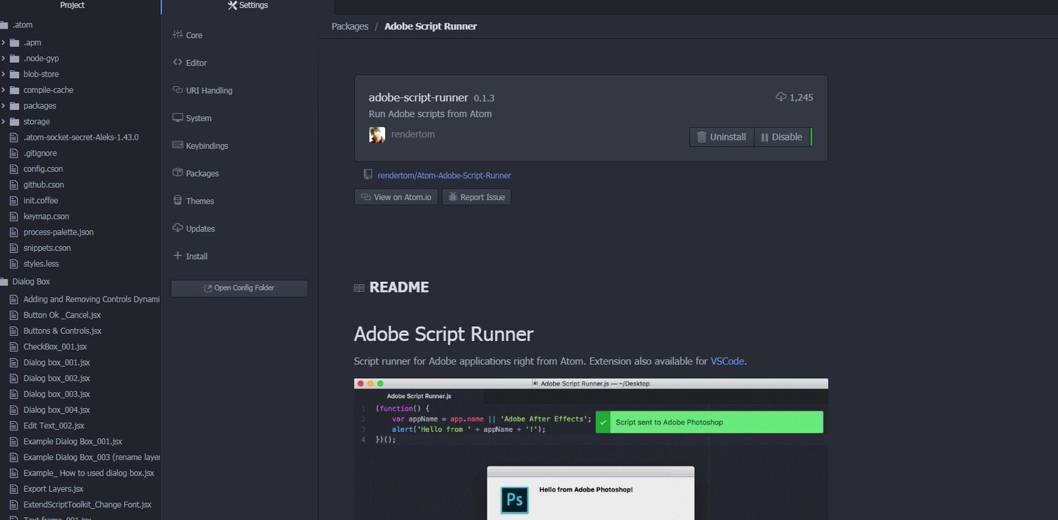

Это оно - adobe-script-runner ?
Подскажите плиз блондинке как связать Atom c люстратором....
вот же -
Settings
Click Cmd+, on Mac or Ctrl+, on Windows and navigate to Packages > Adobe Script Runner to modify settings. Extension exposes the following settings:
  • Save Dirty Document: toggle to automatically save dirty document before evaluating.
  • Run Untitled Document: toggle to evaluate untitled document. Note: document has to be saved prior to evaluating, therefore check Path to Temp File option to set temporary file path.
  • Path to Temp File: path to a temporary file where untitled documents are being saved prior to evaluating. Used only when Run Untitled Document is set to true.
For Windows users only:
  • Path to ExtendScript Toolkit executable: path to Adobe ExtendScript Toolkit executable (ExtendScript Toolkit.exe).
  • Path to After Effects executable: path to Adobe After Effects executable (AfterFX.exe).
  • Path to Illustrator executable: path to Adobe Illustrator executable (Illustrator.exe).
  • Path to Photoshop executable: path to Adobe Photoshop executable (Photoshop.exe).
почему для ESTK ?
Script runner for Adobe applications right from Atom. Extension also available for VSCode.
Ну вот добавила....
там вроде еше надо какой путь то прописать....))))
Чтото я сходу не пойму - так эта хреновина только запускать может или через нее атом адобовскую модель видит?
я поняла так что можно писать код и запускать в приложении.... тока его соеденить надо еще )))
там это все есть....))) Еще круче чем в ESTK
а код писать в разы бысрей и легче.. я уже поняла как )))
нет пока...но думаю должно получиться
Wow!!! Done .!!! It's just awesome....!!!!
