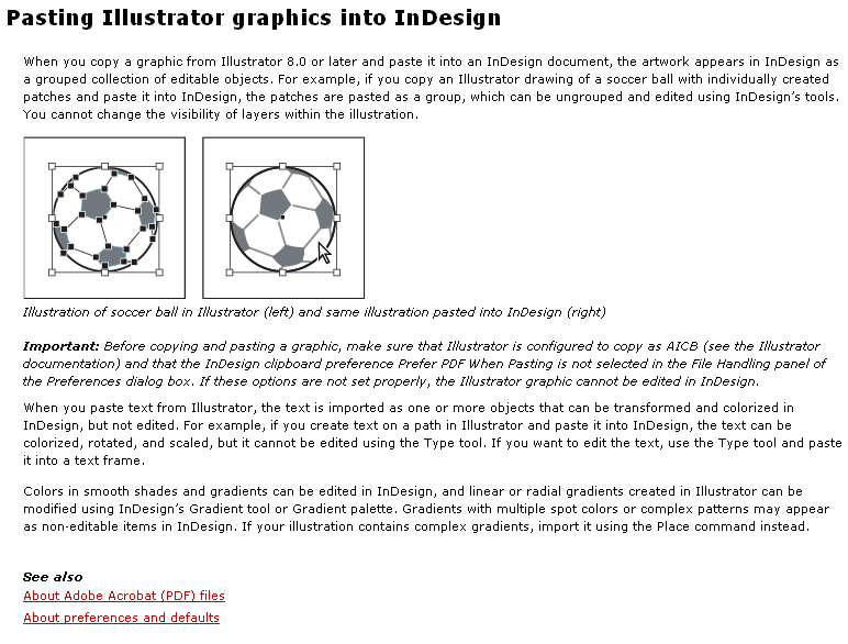

When you paste text from Illustrator, the text is imported as one or more objects that can be transformed and colorized in InDesign, but not edited. For example, if you create text on a path in Illustrator and paste it into InDesign, the text can be colorized, rotated, and scaled, but it cannot be edited using the Type tool. If you want to edit the text, use the Type tool and paste it into a text frame.
Colors in smooth shades and gradients can be edited in InDesign, and linear or radial gradients created in Illustrator can be modified using InDesign’s Gradient tool or Gradient palette. Gradients with multiple spot colors or complex patterns may appear as non‑editable items in InDesign. If your illustration contains complex gradients, import it using the Place command instead.
When you copy a graphic from Illustrator 8.0 or later and paste it into an InDesign document, the artwork appears in InDesign as a grouped collection of editable objects. For example, if you copy an Illustrator drawing of a soccer ball with individually created patches and paste it into InDesign, the patches are pasted as a group, which can be ungrouped and edited using InDesign’s tools. You cannot change the visibility of layers within the illustration.
Illustration of soccer ball in Illustrator (left) and same illustration pasted into InDesign (right)
Important: Before copying and pasting a graphic, make sure that Illustrator is configured to copy as AICB (see the Illustrator documentation) and that the InDesign clipboard preference Prefer PDF When Pasting is not selected in the File Handling panel of the Preferences dialog box. If these options are not set properly, the Illustrator graphic cannot be edited in InDesign.

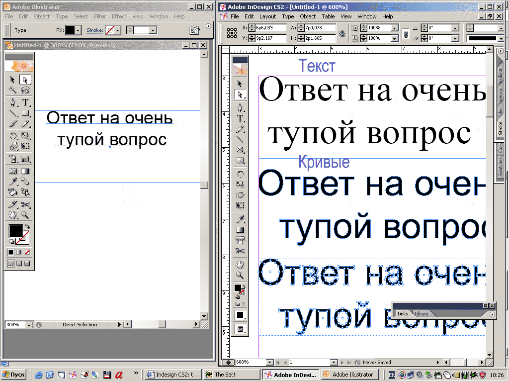

Я тоже не знал ответа на этот вопрос пока вы не спросили. Оно мне не надо было. Взял открыл индез с иллом и попробовал за пару кликов разрешить эту суперсложную проблему.
Если вас интересует именно теория как там все внутри устроено и почему кодлесики крутятся - тады ой. Ищите теоретиков.
    55.2 КБ · Просм.: 974
